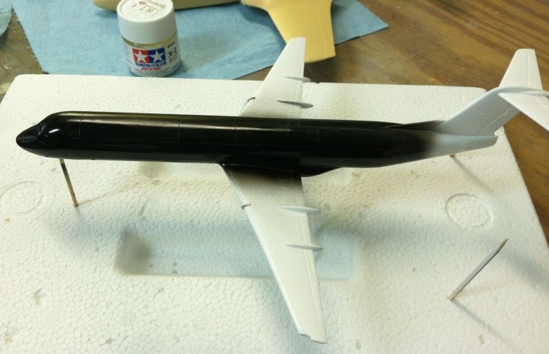

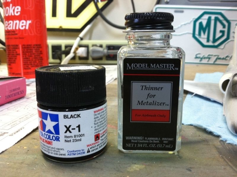

At the Sept. meeting, I mentioned that I'd been experimenting with Clyde's method of using Tamiya gloss black with Testors Metalizer thinner (mixed 30% paint with 70% thinner) as a base coat for Alclad.  I spray at 20psi and the paint goes on very smoothly, and dries very fast. I've also had good results using same ratio of Metalizer thinner to paint with Testors Model Master enamels, Gunze Aqueous Hobby Color acrylics, and Xtracolor enamels. The gloss enamels dry in minutes instead of days, and the acrylic paints seem to hold on to the plastic a little better than when thinnned with alcohol, water, etc. I guess the Metalizer thinnner gives the paint more "bite." Gunze's Mr Color lacquers need their own thinner, and Xtracrylics and Polly Scale acrylics just make a big mess (bigger than usual for me!). Haven't tried Metalizer thinner with Testors Acryl paints. I haven't had any problems with the airbrush (Badger 100G) clogging, regardless of how hot the temp was in my garage.
Here's my Revell-Germany Fokker 100, with its black base coat. The gloss black also really makes the flaws in the plastic stand out, too. If you need to fix something, you can just fill & sand, then hit it again with the gloss black. I was able to handle the model within about 5 minutes of spraying it.

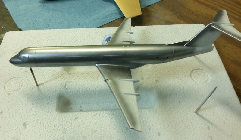

The photo below was taken exactly 15 minutes after the one above, which was taken about 10 minutes after I finished spraying the black base coat. Alclad White Aluminum over the gloss black.
I'll go back and mask the model so I can paint the light grey areas, then it will be time for decals. If I'd had the time today to mask and paint the grey areas, I'd have been able to start applying decals within a couple of hours of starting painting. The Metalizer thinner dries the paint that fast.
